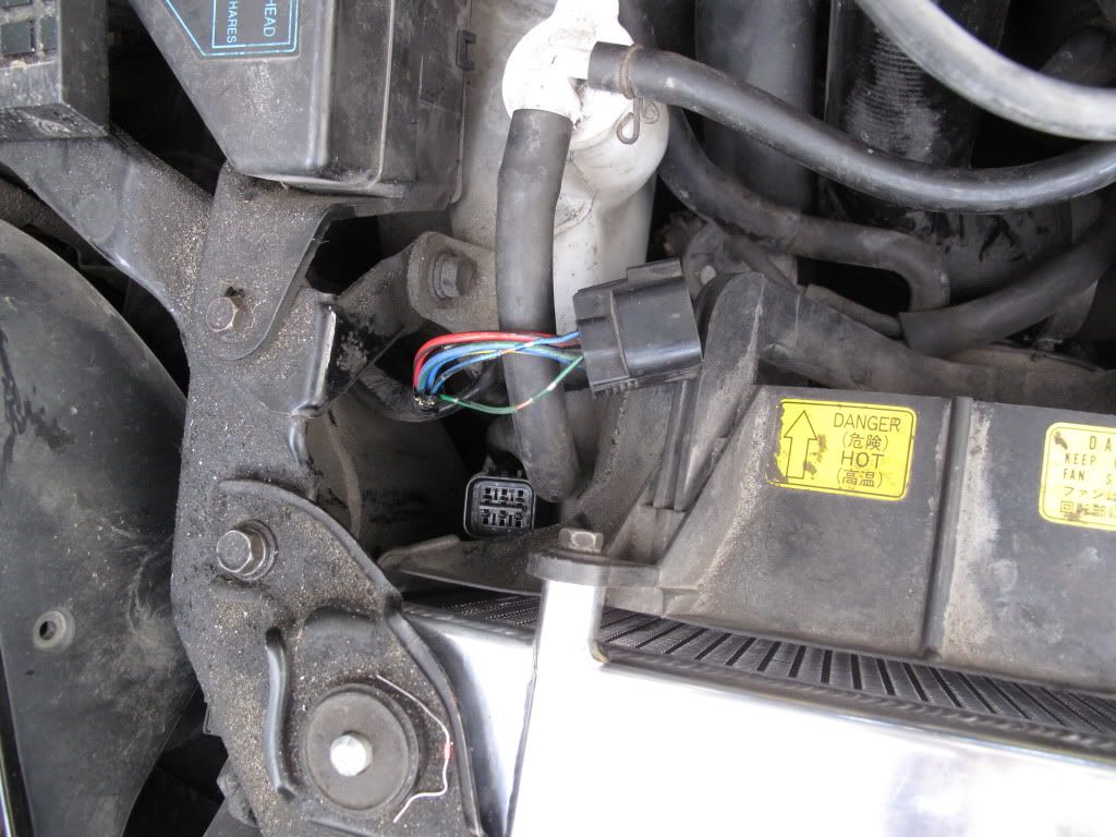

Lately I had some overheating problem (as it seems to be the case of many FMIC users), even with a 2'' Koyo radiator. So I wanted my 2 fans to work 'on' to help cooling when needed, but not having both running as soon as the key is in the ignition aka all the time (hotwire).
So I got a relay installed that will make both fans start together full throttle when needed, and will both shut off together when not needed instead of running for nothing. All or nothing.

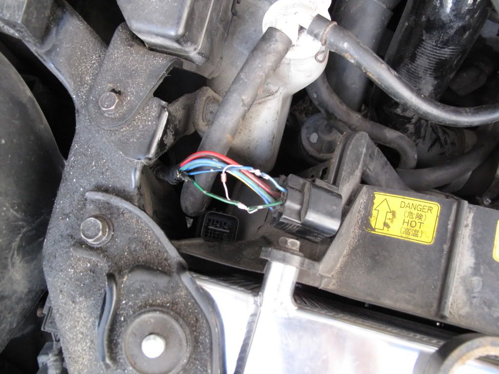

The procedure is very simple for a 91 (I dunno for the other years, maybe the same or similar), but from the circuit diagram we have to connect the #3 & #6 wires (plug A-55) together and that's it.
Simply put : from the connector near the passenger fan, we connect the blue/black wire to the green/black wire together with a wire and put some electric tape over it!
Pictures worth better then words :
So now both fans start together and stop together! :)
Eric
Yes as soon as the AC start, both fans are running as it should!
The only things different are : there is no more low/high speed, only high and there is no more only one fan running, both are running all together, and stop all together.

Yeah the passenger side fan was touching the lower IC pipe a bit, but we moved it a bit and it's fitting very tight! We had to push the condenser bolt (along with the AC rad a bit) to make the koyo fit!
Just check if your circuit diagram is the same if it's for your 93.
